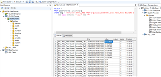

Hi. In OLEDB, you're querying the piinterp table, which yields interpolated values starting at '*' with the given timestep (default: 1h). So the values you get are timestamped xx:09:51 because you ran your query at 09 minutes and 51 seconds after the hour.

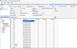

Change your query so you're pulling from the picomp2 table instead, which holds compressed (archived) values instead, and you'll see they'll match the timestamps from SMT
Hi, thanks for the help working now.
