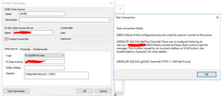

Hi.
I am trying to set up system DSN for ODBC connection to SQL DAS, but I keep getting an error message when trying to test the connection.
I have checked that the ports are set correctly in the SQL DAS config file and that I am using those ports in the config of the ODBC DSN. I've read through the ODBC driver admin guide and the SQL DAS admin guide, but I can't seem to figure this out. I am sure it is a detail I am missing somewhere... If anyone have any pointers, I would appreciate it.
-Olav

  • Hello ​ ,
    I believe that you are trying to connect PI ODBC Driver (indicated by "PI OLEDB Provider" Type) against PI SQL Data Access Server (RTQP Engine) (indicated by Net.Tcp via port 5465). This will not work because these products are 2 different PI SQL generations.
    If you like to stick with PI ODBC Driver, you need to install PI SQL Data Access Server (OLE DB) as the server component.
    If you like to stick with PI SQL Data Access Server (RTQP Engine) which is what I would recommend based on the information shared, please use PI SQL Client (ODBC).
