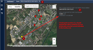

We created a custom symbol to display markers on google maps in PIVision.
This is based on AF Attributes within an element that provide Latitude, Longitude, name, value, ...
Clicking or hovering a marker will show a popup with some info or PI data about the marker.
We would like to also add the feature that clicking a marker would adjust other symbols on the display to the selected asset.
Basically as if the asset dropdown at the top was used to switch to a different asset but activated by clicking a marker.

While debugging, we can see that the datasources of the other symbols are actually modified. However, the label and value of the other symbols is not updated to the last clicked asset.
It seems to partially work but not correctly.
For example, if you click a marker (symbols on display not updated) and then select a different asset from the dropdownlist on top, the display suddenly switches to the asset that was clicked on the map previously instead of the newly selected asset.
This seems to indicate that the trigger to update the display is somehow not working. There might be other side effects with the current implementation.

Attached, you will find a screenshot with some explanation.
