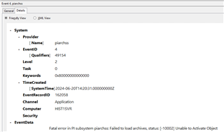

  • I am unable to view the event logs from the initial failure but I restarted the computer and see this failure message pop up.
