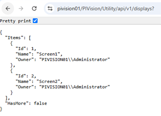

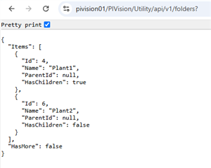

However the other APIs, Get Displays ( GET /api/v1/displays
?FolderId={FolderId}&Skip={Skip}&Count={Count}) & Get Folder (GET /api/v1/folders
?FolderId={FolderId}&Skip={Skip}&Count={Count}) are working as expected,
Get Displays API
Get Folders API
