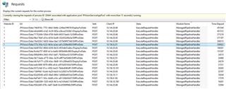

Hi everyone,
I reference the article "How to Troubleshoot Performance Issues in PI Vision".
Link article: https://customers.osisoft.com/s/knowledgearticle?knowledgeArticleUrl=How-to-Troubleshoot-Performance-Issues-in-PI-Vision
My situation is suited to Case 2. And some information.
- I confirm machine resources (memory and CPU usage) are not at 100% (about 10-15%)
- The types of data items on the display are only PI Attributes referred to PI Points.
- The type of symbols on display around the "Value" symbol.
- About the browser: For now, I use Chrome, and I try to access it by Edge but it's not better. And in the last time, the system is still normal.
- I tried to create a new display that only uses PI tags directly. This display should load quickly.
- I tried to load data using other PI clients still smooth.
Hope for help.
