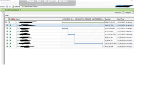

There is a way to create a event table with the parents EF and the child since they are not from the same EF template?
I migrated batch data to EF which generated parent events with children, and these children also have their own children events, and so on. The parent event has a template type, different from the child event, and so forth (each level has a template). When I try to create a table similar to AF in Vision, it's not possible because the levels are different. Is there another way for me to replicate this table in Vision?
