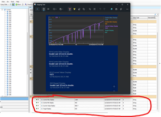

Getting the error "Invalid Cast: [Error] to double." when trying to display attribute as PI Vision Value
I made a template for a bunch of elements and when I try to display the value of certain attributes from that element, I get that error. What doesn't make sense to me is that all of the values show up on a graph but when I try to put it onto a pivision page as a value, I get that error. The current value is based off of a tag value and the other three that don't work are based off of a static table lookup value.
Since they are all in PI AF as strings and all have values reading to them there, I do not see how this could be happening.
When I use this template with different tables, it doesn't have this issue, so I figured it must be a problem with the table but there are no differences between the tables other than the numbers input into them.
