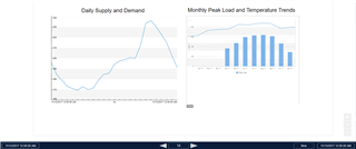

I am working on a solution where I need to show the daily trends along with a year to date trend on a PI Vision dashboard.  I understand that this feature is not available with PI Vision 2017 and I could not think of a workaround to implement this using PI Analysis. However, there is one other alternative, which is to embed a PI Vision display inside another PI Vision display using the embedWebPage custom symbol. The downside of this workaround is that we need to create multiple displays to build one dashboard. What do you think about this? Is there a better way to set multiple time ranges for trends and custom symbols on PI Vision 2017?
Here is my test display with multiple time ranges:

    I'll preface this that I haven't poked around too much with embedding other pages in Coresight/Vision, but I think I may have a different route for you to take and still accomplish what you're looking for. It looks like that year to date trend is a custom symbol, so you could explore the possibility of making the time range whatever you want for the custom symbol since it doesn't have to get the timerange from the webpage unlike the built-in symbols. That would prevent you from having to create multiple displays and embed them in this parent display. This assumes that you're only using these two symbols, if you have other non-custom symbols with different time ranges as well. Then I think the workaround you're currently implementing is the best I've seen so far.

  • Thanks, Robert! I was not aware we could set start and end time of the individual custom symbols. I will give it a try.
