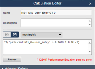

This should work if you remove the parentheses:
IF 'bucam:NS1_MW-user_entry' > 0 THEN 2 ELSE -2
You can find the documentation here: https://docs.aveva.com/bundle/pi-server-f-da-smt/page/1020221.html
Perfect! Thank you!
While you can do that, bear in mind that AF is going to be far more performant and less taxing on the system than using calculations in Vision.
