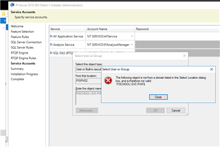

I am working on the setup of the server on PISVR02, I tried to follow the instructions given but keep getting the same error. Am I good to proceed with the default? any advice?
Hello AlisonB ,
I believe that you need to select a different source. Please refer the "From this location" TextBox. 'PISRV02' will be the local machine. Please click [Locations...] and chose either "Entire Directory" or "pischool" domain underneath.
It only gives me PISRV02 as the location option. Entire Directory or pischool domain do not exist
Hmmm .. can you please verify if the machine is still member of the pischool domain?
One way to go is via Windows File Explorer -> right click on "This PC" -> Properties -> Advanced System Settings -> Computer Name -> Change. Please see the Member of section.
It happens from time to time that virtual machines domain membership is lost and they need to be rejoined. Another option would be to spin up a new set of virtual machines from the course related template.
