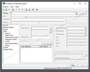

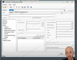

Hi everyone during try to do first exercise and i was logging to PIINT01 Server everything going well till i did open ICU I didn't Find the interface, as i following the instructor
In course
^ In my VM
In course
^ In my VM
You need to create new interface first. Open PI ICU, select Interface > NewWindows Interface Instance from Exe. Enter the require information.
