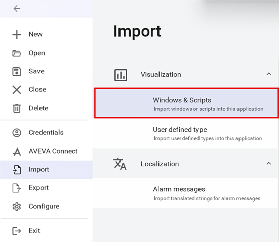

In your new $InTouchViewApp template, select the Menu | Import | Windows & Scripts

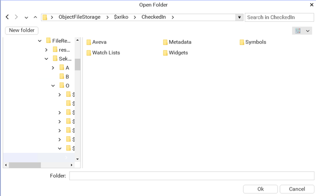

Navigate to your source application.
The default location for all applications in your galaxy is:
C:\Program Files (x86)\ArchestrA\Framework\FileRepository\<galaxy name>\ObjectFileStorage\<$ApplicationName>\CheckedIn
Click Ok

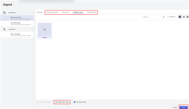

Now you are prompted to select the things you want to import.
Note: If you are referring to InTouch tags in your Windows or scripts, and you know these tags exists already, check the 'Use existing tags' checkbox, otherwise you have to re link them by using the convert - local function in the script.

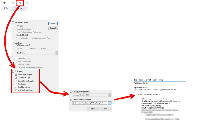

And as a side note, perhaps not advised in your specific scenario (since you can not import this file), but you can also use the Print function and export your scripts to a text file, great for simple script backups, bulk search or documentation.
