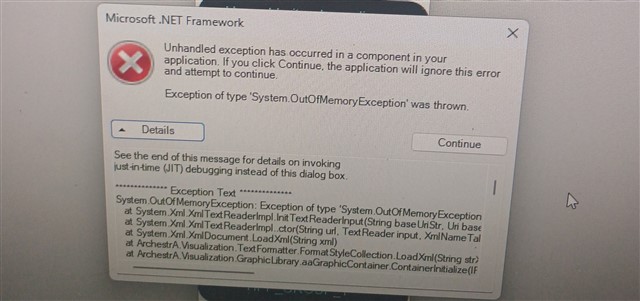

I'm facing errors and bugging during runtime ,
The runtime became so slow after working and opening windows for one day for example ,
Sometimes It shows the below error related to .NET Framework

This is a pretty generic error message that need some context to sort out, but it seems to originate from an Industrial Graphics Symbol.

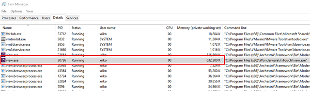

But I would personally start looking in to identifying any kind of memory leak, set up some monitoring of memory consumption of view.exe, or just see if you can provoke the issue and keep Task Manager running, if memory consumed starts to go up after a while of running the application you can start going further from here.

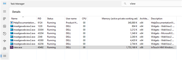

Thanks Richard for your reply ,
I'm using AVEVA InTouch HMI 2023 R2 with Patch 01

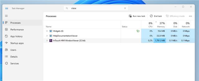

I've noticed many times that after a random duration the memory consuming is going up as you said ,
It doesn't happen because of  a specific window or symbol , It happens randomly ,

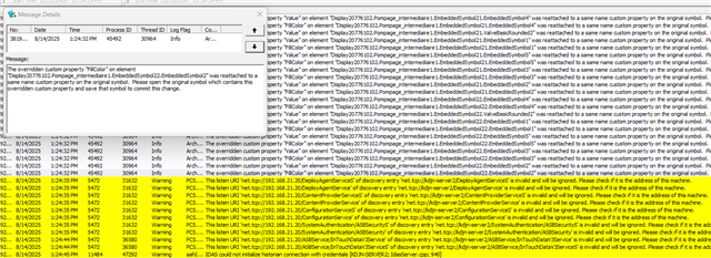

However the below are some warnings recorded in the log viewer ,
I will check them but I'm confused does those errors causes this problem of hanging and consuming a lot of memory ?

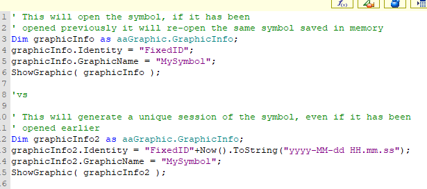

Almost 2gb of ram could be considered quite high for an InTouch application, but its hard to say since you can end up in this scenario due to many reasons.
If you have extensive use of show symbol animations scripts and generate unique Identity for each one, then your application will consume (and never let go) of ram if not handled correctly.
Above example is for illustration only.

The warning that you see can originate from this galaxy being migrated from an older version where the naming restrictions of custom properties were not enforced in the same way, and you have symbols that you have to open and save to complete the migration.

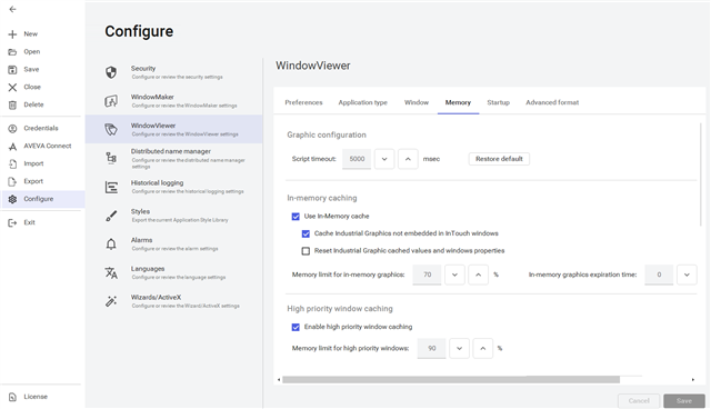

One thing to test as well, is to review the memory settings of your application, are you using in-memory cashing? You could try to temporarily turn this off do see if the behavior changes, you might end up with a slightly slower application when navigating, but it would be interesting to see how it effects memory consumption of your application.

Thank you ,
I've been made the identity as you preferred and tried this for some defined screens and symbols and kept navigating between them while the task manager is running , Unfortunately I've noticed that the memory consuming is still getting high till reaches 2.5Gb and then the program gets too much slow and shows the same message of Microsoft .Net Framework error
I also tried before to disable this In- memory cashing property , As you said It makes the navigating slower and also not making a significant difference because when trying too much navigating the memory consuming gets high .
Also I would make a case for tech. support but Is it usual for the memory consuming to get high when too much navigating ?
