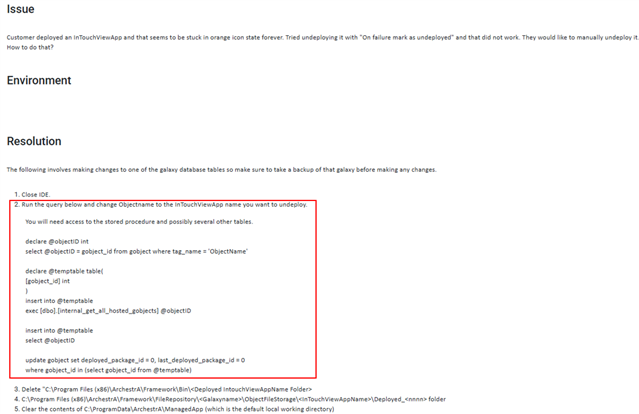

Force undeploy an InTouchViewApp stuck with orange icon

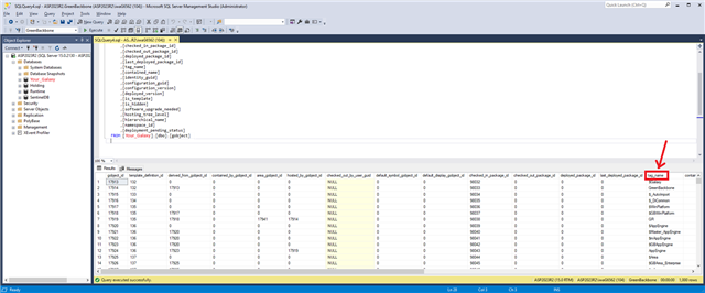

Kindly help where will i run #2 query. Thank you in advance.
  • Hello AV, the "gobject" table is in the Galaxy DB. Open Microsoft SQL Server Management Studio, click on the galaxy database and run the query from there.

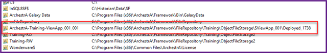

    • The first step that in the deployment phase is the creation of a deployed folder on the GR-node.
    • De necessary files for running the ViewApp are generated/compiled and placed in the deployed folder.
    • A share is created on the GR-node for this folder specific deployed folder. (see example below)
    • The target node (where you are deploying to) will be informed that a ViewApp application is created and placed in a shared folder.
    • The target node will now copy over the entire content of the deployed folder of the GR-node to a local folder on the target node: “C:\Program Files(x86)\ArchestrA\Framework\Bin\ViewApps\[ViewApp_Name]”
    • During this copy process from GR-node to target node a file: “Deploying.view”exists in the local “C:\Program Files(x86)\ArchestrA\Framework\Bin\ViewApps\[ViewApp_Name]”.
    • If the entire ViewApp instance is copied over the created share on the GR-node will be removed and the “Deploying.view” file on the target node will also be removed.
    • During the copy process the orange sync icon will be shown on the ViewApp instance. Depending on the size of the application this can take a while.
    In some circumstances the orange sync icon won’t disappear meaning that the copy process doesn’t works. It’s has become in a stuck mode.
    One of the reasons we have seen is due to a share that isn’t removed for this ViewApp instance in a previous deploy/undeploy action.
