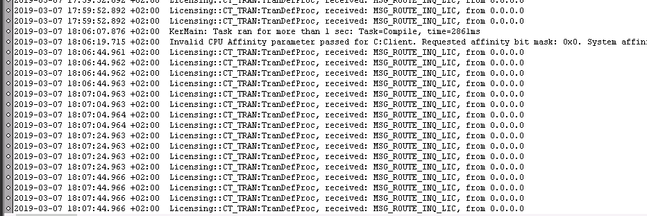

  • I have Citect SCADA 2018, version 8.10
    Here is an extract of syslog.dat when client shutdown.
  • Unfortunately, that doesn't have any useful messages. Can you copy the text from the "Citect Startup" message to the end of the file instead of taking a screen capture?
  • Here it is:
