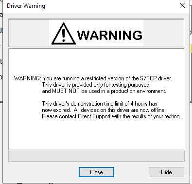

I’m currently experiencing an issue with the S7TCP driver in AVEVA Plant SCADA 2020 R2. Upon launching the system, I receive an driver warning stating: "You are running a restricted version of the S7TCP driver."
Here are the details of my setup:
AVEVA Plant SCADA 2020 R2 with a perpetual license activated via the Floating License Manager
S7TCP driver (latest version) installed and licensed
The S7TCP driver license has been successfully activated in the Enterprise License Manager
Despite the license activation, the error persists and the driver appears to be running in restricted mode.
Could you please advise on how to resolve this issue? Any guidance or troubleshooting steps would be greatly appreciated.
