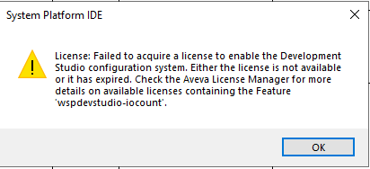

this morning when i tried to open my IDE "System platfrom" i got this Pop up :

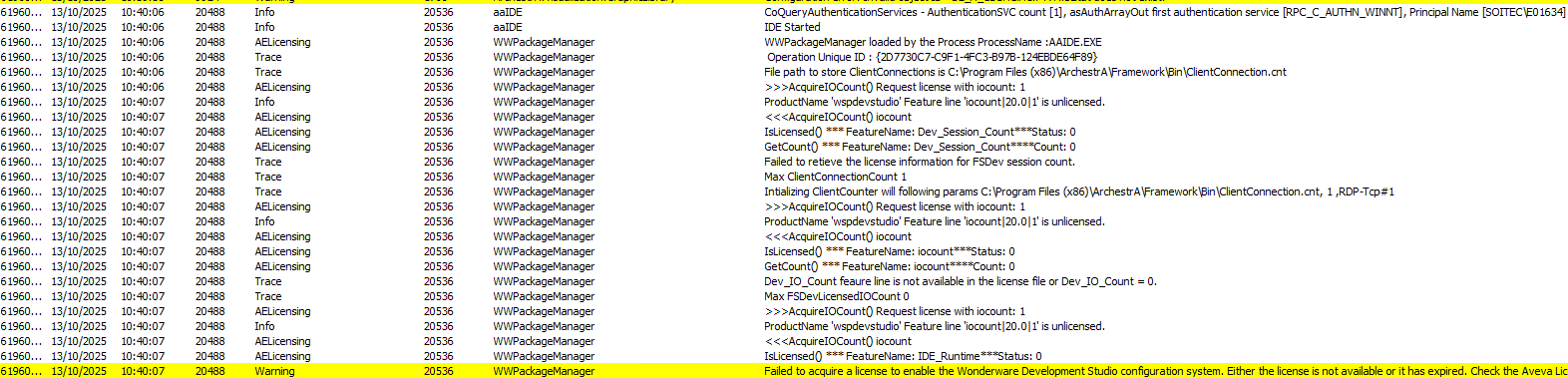

Failed to acquire a license to enable the Wonderware Development Studio configuration system. Either the license is not available or it has expired. Check the Aveva License Manager for more details on available licenses containing the Feature 'wspdevstudio-iocount'.

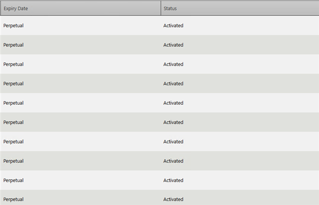

i don't know the real reason of that , after i ve checked my SMC logs i got this  its talking about : "Failed to retieve the license information for FSDev session count." , but its funny cause in my licence manager i didn't found anything strange , all my licences are avaliable ,

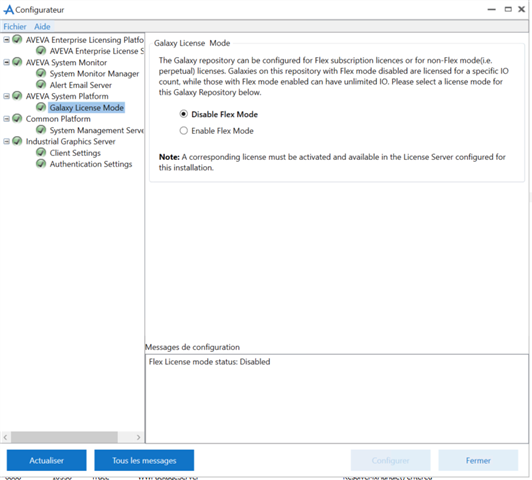

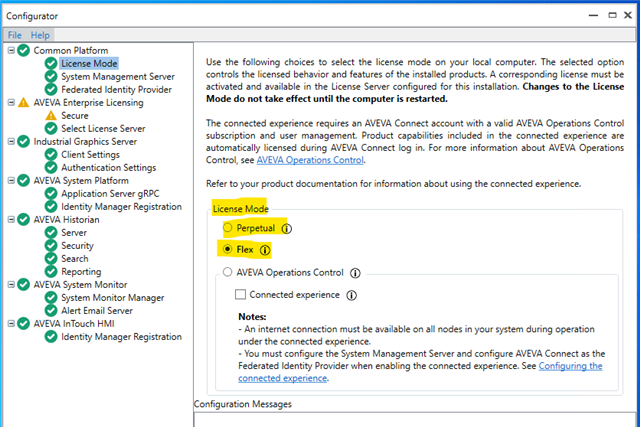

  • Is your license a perpetual or flex type license? Currently it looks like you may have a flex license, and your configurator license mode is set to perpetual or maybe the other way around. In the configurator is where you can set the license mode based on the type of license you have.
    If the above is correct, then try restarting the aaGr and aaGlobalDataCacheMonitorSvr services.
  • Hey   !  thank you for your help
    my licences are Perpetual :
    i also tried to Restart the aaGR and aaGlobalDataCacheMonitorSvr : still have same Problem :(

  • We too are experiencing this issue.  Changing to Flex and back to Perpetual with restarts has not worked. Adding the license key again has not worked either.
