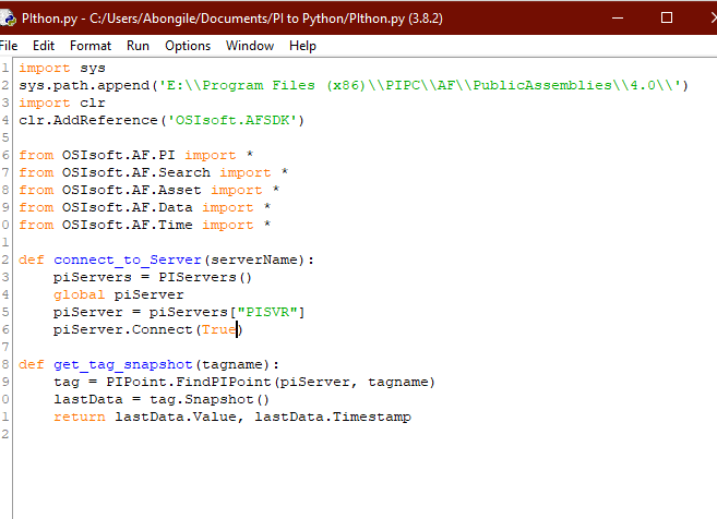

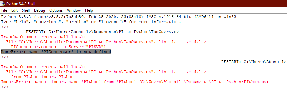

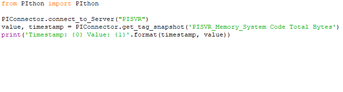

  • Hi,
    Please help,
    I have followed the steps. I am not sure if I am missing something. I have created the PIThon script.
    I have also following script.
    I get the following run time error message.
