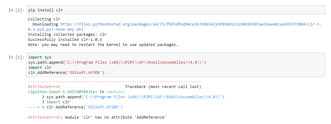

Proceed with the installation of everything and once it's done, go ahead and create a module called PIthon. Now comes the most important part: libraries import.
import sys
sys.path.append('C:\\Program Files (x86)\\PIPC\\AF\\PublicAssemblies\\4.0\\')
import clr
clr.AddReference('OSIsoft.AFSDK')
