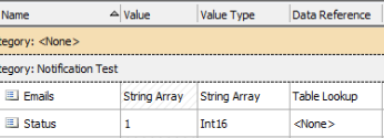

The attributes for the table lookup testing:

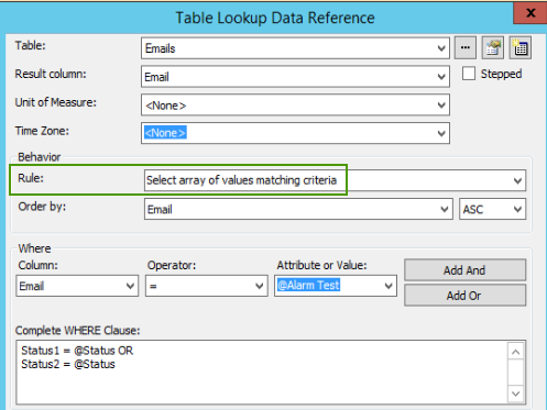

The table lookup configuration; to my surprise the Behavior Rule allows you to return an array of values when the attribute is set to an array type:

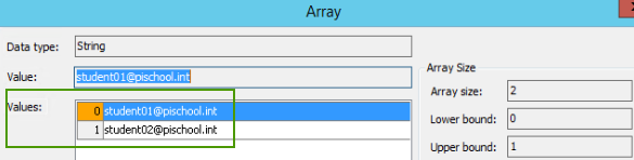

The resulting attribute value when Status = 1:

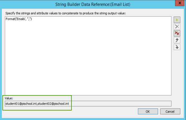

So now I had my array of values, but how to build the email list from this? Recently I was playing with Format function in the String Builder data reference and noticed it had the ability to handle arrays (function syntax like, Format(array, delimiter)), but I thought at the time, “what would you use that for?” Well now I know of at least one case! The final step here was to add a String Builder attribute called Email List and use it to convert the array above into a comma separated list:
As you can see from the Value field, we get exactly the list we want to plug into our notification dynamic email delivery endpoint!
