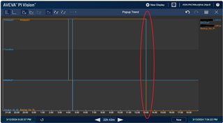

We have a failover pair of OPC interface. UFO type is Hot. Both interface connected with primary DA member of collectives.
In below snippet, blue has Failover ID=1 and orange has failover ID=2. We can see that blue one went to Backup_No_PI state for a moment then came back to Backup state. but the same not happened with orange trend. Orange trend kept in Backup_No_PI state for long time.
Q1. Can interface failover successfully If interface remains in Backup_No_PI state?
Q2. What was the possible reason behind orange trend could not come out of Backup_No_PI state?
