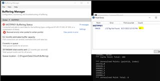

Please verify if the PI Point exists. If it exists, please make sure the PI Buffer Subsystem service account is permitted to see the tag configuration (ptsecurity). The service account should be mapped to a PI Identity. This identity needs read access to the PI Point.
hello Gregor.Beck , thank you it is resolved now, cleared all the unresolved points and restart the services. Then, the buffering status is clean.
