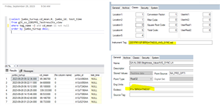

I am trying to configure my PI tag to be able to read data from an sql database.
the query works well and I just want to fecth the latest Cd_mean value. how can I configure my PI tag to store that value in a PI tag

Setting Location2 to 0 (process only the first row) should do the work, as long as you can make sure the latest value always comes onto the 1st row.
Thank you Damian Nguyen what about if I want to select a specific colum(is that location 3 configuration?) . also can you please what location 4 and 5 are for.
